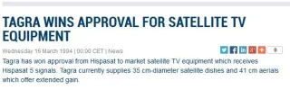

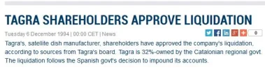

These 2 news clippings from 1994 show happy and sad events for Tagra in the space of 6 months.
View attachment 73117 View attachment 73118

Think the company is a front for " Mas Enterprises , Catalonia, inc !" " Viva Catalonia "
Well, that would work in Gotham City!
PS, FTE´s are still made in Barcelona, and are very good dishes!
