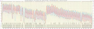

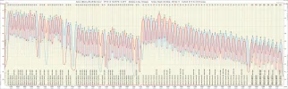

Started to do some activities with TBS 5925, such as scanning and making spectrums. This is result of scan from 19,2*E
OOOOOOOOOh....that is nice.......love my 5925, hope you get the same enjoyment.
