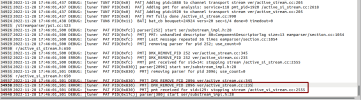

I don't know if it only happens to me, but with the 6903 cards, every time it scans 11221 H,30000,3/5,8PSK(or 11261 H,30000,2/3,8PSK) at 16.0E, neumoDVB crashes.
@Lwel, can you check if you also have problems with this mux at 16.0E? Thanks :)
satesco, 11221H doesn't show for me. Seems to have disappeared. Next that, 11227H has no SNR.
Trying 11262H shuts neumodvb down (I just managed to take a screenshot before that happened.)
2,143
3,061
Thanks, @Llew, for trying. It may well be that the crash happened at the time of the switch from 11221 H to 11261 H because before the crash, I noticed that 11261 H turned green, indicating that the mux had been scanned but without being able to take a screenshot.
What is strange is that your spectrum shows that you have a mux at 11227 H(why?) and not at 11221 H. Probably that's why the app didn't crash until 11262 H(?).
In the neumoDVB log I posted above, I highlighted the error 34938 that occurs when the crash occurs. That error occurs every time.
