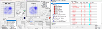

It would be better if the monitor fits.

I marvel at your ability to find solutions and improve your app. Probably, to exaggerate a bit, that chip Stid135 is a kind of "intellectual aphrodisiac" for your mind. :)
I've read the improvements and new features for the subsequent releases. Just reading it takes time. What about working as such to fix bugs or add something extra to your neumoDVB?
I can imagine that this project eats up your time, so I have the reluctance to suggest you consider for the future, for 6903x/6909x cards, the possibility to indicate the presence of generic streams, and if it is not an impossible claim, at least to display information of these streams, as you can see with Crazyscan under Windows, a mux with S2X extension to 10.0E.
