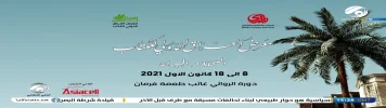

the 4.2.2. is visible by all Enigma2 receivers with the help of OpenWebif and VLC, and also other receivers that are not E2 like the V8 GT Media Turbo but with WinGTshareTool and with the video player you want.
Here with PotPlayer
