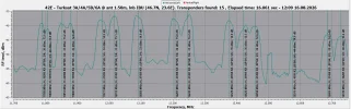

Signal and multiplex test at 42.0E – Turksat (3A)/4A/5B/6A, today, 16 August 2026.
This is all I’m receiving in my area from this position. I’m also including a carrier test at 11611 V.
