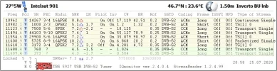

Hello satesco i have read for a few days on what usb card to buy is the 5927 still the best usb card to buy now? i want to monitor only signals to see if it's worth to upgrade my dish so it needs to be a very sensititve card also do they come close to a vu+ zero 4K or octagon sf8008 for example in sensitivity my budget is 250 euro wich is exactly the price of this card + shipping if there is something realy good i can up the budget to 500 euro i have read the pdf from you with many thanks still learning about sat cards and i will continue to read thanks in advance
2,183
3,161
Hi SnelleJef,
Thank you for your trust,but I confess that I'm put in a messed-up situation,to recommend a product on other people's money.And I don't want to make a mistake at other people's expense,in this case,yours.
I also have to add that I do not know the sensitivity of the two receivers mentioned by you(Vu+ & Octagon),because I have never tried them.The only thing I can say with certainty without mistake that the tuner of 5927 is the most sensitive to weak signal as that of the 6983 or 6903.It's actually in the same performance class as the last two,and besides,has full crazyscan support.
From this point of view and with dvb applications 5927 can be used for many things,i.e.signal checking and monitoring, MIS reception, antenna installation,reception of special parameters, etc.But you should know that it does not read and lock the transponders with the S2x extension!You must take this into account if you want to compare it with,for example,Vu+ or Octagon.
I ran an IQmonitor test at 27.5W and,as you can see,the app can scan like 6983 or 6903.
Regards

Butacas
May 4, 2019
92
84
90 cm motorised dish (1 m x 90 cm) + fixed [DiSEqC 3 x 1] {80 cm x 74 cm} Hot Bird 13° E, {65 cm} Astra 19,2° E & {60 cm} Hispasat 30° W + fixed {60 cm} Astra 28,2° E.
Motorised dish currently: 40,5° West to 45° East.
Vu+ Solo SE V2, Vu+ Zero 4K, TBS 5927.
Spain, Galicia (Ourense)
Hello SnelleJef
The vuzero4k's tuner is good, but it has a driver problem. The signal levels it displays are not actual. It is a problem that
should put solution vu+ and that they do not.
TBS 5927 is more sensitive.
