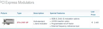

remlap said:
Now the question is how do we view it.
Perhaps with this card.Too expensive for our own pockets :(
