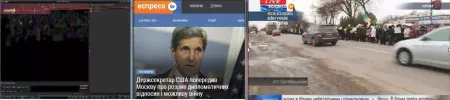

BlindFaith said:
...With a card like TBS5/6925 you can lock the carriers and make some guessings about the content
If you've got a high Data Rate on the transponder with Continous stream, you have the chance to see what the media content is and what is the provider of that stream,but also to have some luck the video pid is not coded.So it's not a guessing,in the example given by me on 12657 V-27.5W,is a stream from Espresso TV Ukraine,as you can see after the Logo in picture.
Unfortunately, I have met many media streams which had the video pid encoded,but in most cases audio pid is in clear,such as the one at 100.5 E-12463 V.
But to see such Continous stream smoothly,you need a dedicated PCI modulator, such as those from Dektek .

I bet you can't upload a chunk of 2 seconds continuous video ;)
The reason that Transedit's analyser shows the PIDs is a badly implemented TS_sync detection. Try TSReader or other analysers. These are internet streams (provider: ffmpeg, gooogle) with ts_packets embedded in a continuous stream. To read a PAT a single ts_packet will do cos a section fits in a single packet. Likewise with other tables.
It reminds me of the early attempts (10 years ago) to extract jpegs and other files from ts in IP/DVB mode.

well, sometimes the streams are incorrectly flagged as continuous or ts. If it's TS, you should be able to see a correct analysis without many missing packets ;)
