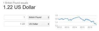

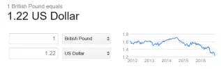

8,720
Are they like £ ????
Silly me, of course they are as of another couple of weeks time!
