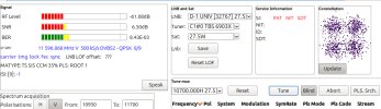

11597 V,333,2/3,8PSK-Data/radio stream,new,(credit goes to @superdish66).

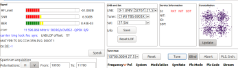

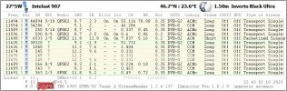

27.5W_11690.285 V,363,2/3,8PSK-11690.285 V,363,2/3,8PSK-Data, new.
I couldn't find any radio streams on PID 101

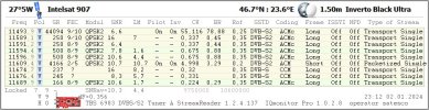

11609 V,4165,2/5,s2-Pid 512. The three IPTV services work with the same parameters except for the new symbol rate.
