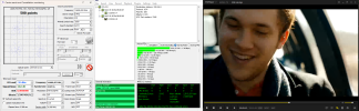

I apologize for the translation this morning but the phone played a trick on me
in the photo below you can see the power of the 2 tp that are received in Italy spot Central
which make reception of the BBC mux impossible at my latitude

Indeed, the two trps(11012 V and 11137 V) with symbol rates 107141 have long been active and have a strong signal in many parts of Europe.
