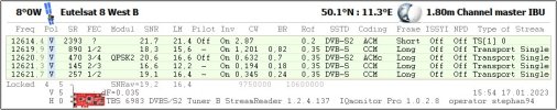

I find the same transponders with very small SR with a TBS6983 card, an Inverto black Ultra LNB
and the IQMonitor program
all in blindscan8°0W_2301171554_12600-12640 V .jpg8°0W_2301171554.jpg8°0W_12621_V_5740.jpg

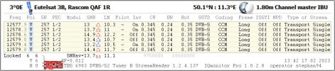

A test on 3° East to get the nearby small sr .
All six frequencies with radio stations are found without problems (only without name).

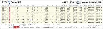

Can you find out the SNR on these 21.6E muxes, which I know are on the West beam?

Great, @cirio70.
11579.90 H 512 2/3 (DVB-S): Radio Mediterranèe
11598.96 H 256 3/4 (DVB-S): Radio Chada
11604 H: Could be one of the radios we found above
11611 H 5453 ACM/VCM
Bye
1,930
2,688
I wish I had a stronger signal to be sure that all the muxes found by IQmonitor are real. That's why I couldn't work with the dongle. Too many have 170 symbol rates, which makes me wonder :confused

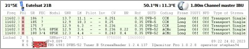

A couple of days ago I had a look at the 21.5E low symbol rate signals around 11603H using the Amsat DL DVB demod program and managed to lock two of them but no audio found.
11603.1H DVB-S s/r175 and 11603.9H DVB-S s/r175. As I didn't know the fec it was very difficult to resolve the signal and get "sync confidence"=32.
SimonE
Feb 26, 2015
329
321
79
Gloucestershire, UK
This morning I have managed to lock a DVB-S2 signal at 21.5E. Complete lock with audio using VLC player. 11604.4H s/r=175 8PSK 3/4 from SNRT labelled DAKHLA.
