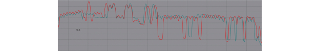

yesterday and today compared. Not much to see in this plot.

But the biggest change does seem to be on the 2F UK transponders.
Yes. I'm 100% sure they've moved. The wobble pattern is completely different now. I will post a whole days run tomorrow, then it should be obvious.
