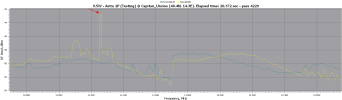

For a few hours now, the telemetry signals have been turned off on the frequencies 10707.00 LHCP, 10709.00 RHCP and turned back on on the frequencies 10951.00 RHCP, 11449.00 LHCP.

In the last few days, there was only one test carrier yesterday morning. and with the change in telemetry frequencies, I suspect that the displacement maneuvers will begin soon. I'm monitoring the position....
473
1,840
Yesterday evening the telemetry signals had a drop in power (a sign that they have been switched to an omnidirectional antenna), already this morning a slight movement towards the east is noted. Let's see in the next few hours if the movement maneuvers have actually begun.
Yes I can confirm a drop of signal power of the main beacon and telemetry frequencies at 10951 and 11449 yesterday 1740 GMT and a notable movement towards east since 0900 GMT this morning.

It is starting moving indeed
473
1,840
From the TLE data, it is moving at about 0,5° per day... and from measuring the strength of the telemetry signals, I can confirm that it is moving east.
