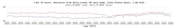

Current orbit is slightly elliptical so 2E has a daily cycle wandering between 28.30 and 28.42.

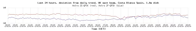

I realigned my 1.8m dish yesterday. Graph attached. Look at around 17:30. Picked up lots of signal on 2E for almost no trade-off on 2F.
Very interesting. I imagine you are now focussed between the two sattelites ? 1 - 1.5db gain is i think a jump in dish size e.g 1.2 - 1.5 ?
I used 10818V as the guide. Plenty of signal on 2F so I concentrated on 2E and it doesn't seem to have affected 2F at all. If anything it has improved a tad. If I map the current level for the last 24 hours against the daily trend since switch-on I get this.
Interesting .... being in the same area as you and having a 1,2 offset makes me thinking on readjusting the dish
can you confirm if the gain is noticeable across the day ?
You can see it in the graph in post #502. That is today's SNR compared to SNR since switch-on. So, for example, baseline is signal reading since Thursday at 6am, split into 10 minute sessions on all QPSK transponders. Then today's reading is superimposed on that baseline. So anything above 0dB is better than an "average" day. Right now I'm about 0.5dB up on 2E across the whole day.
I should have thought to filter out the weather differences the most obvious measure is the change when you adjusted the antenna ?
