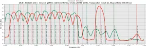

Black Ultra is not for reception 2F/2E satellites because there are bad cross-polarity ratio. Invacom Quad QDF031 is great, but only in the horizontal signal. If you want to get both polarizations try Inverto Black Pro C120. It is an excellent and inexpensive LNB and only with him i have all frequencies with 2E satellites ....

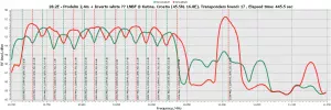

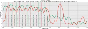

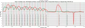

This is my measurement with 10 different LNB few months ago while he was still working Astra1N/2F.
Pictures say more than a thousand words.
Alps BSTE08.png Alps BSTE08.png Digiline US16.png Alps BSTE08.png Digiline US16.png Alps BSTE08.png Digiline US16.png Humax SP1.png Inverto Black eco.png Inverto Black pro -c120-prodelin feed.png Inverto Black ultra c120-prodelin feed.png Inverto Black ultra.png Inverto White.png Mti BlueLine.png QDF031-C120-Prodelin feed.png
