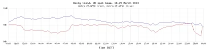

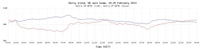

Last week in February compared to last week of May.

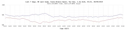

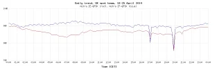

Yes but the pattern is different too. Each satellite follows a pattern where every day is almost identical to the previous day. But now that pattern has slowly changed over the 3 months the satellite has been active. Is this pattern due to parts of the solar array being blocked by the antennas at certain times of day?
I'll post the patterns for March and April later. Shift is gradual but seems sudden when a certain size dish goes over the cliff edge, which is what is now happening in Torrevieja with the badly set up 1.4m offset dishes.
Ok, here are the 4 months together so you can see them one above another.
Huevos, as we approach the summer equinox, is it possible the signal may get a little (I hope) worse and then start to improve again? If your theory is correct about solar collectors being in shadaow by the bird itself, it should improve after june 21st? Anyway, theory makes sense that it affects 2F more than 2E due to the number of active transponders.
Or is it the conspiricy theory? ..... or an alien attack!
