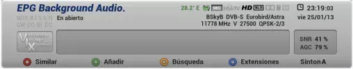

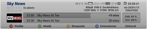

Huevos what frequency are you guys talking about ? Sky news HD or SD ?
6,036
1,273
SD -> 12207V. There is no way this is on 2A. Compare to a typical 2A transponder (11778V -> EPG Background Audio).
11778V -> SNR = 41%
12207V -> SNR = 81%
Values using a 1.8m PF dish.

Huevos ... I'm getting this in Lisbon with the same size dish as yours ... care to comment ??
