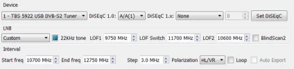

P.S. are these settings correct??
Well, generally they look alright. You may change the LNB to Ku-linear instead of custom, the settings will be the same. You may also increase the step to 4 or 5 MHz, if you want to speed up the process...
