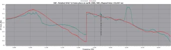

getting some strong spikes here
edit: added approximate frequencies to pics
