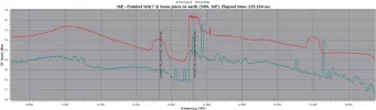

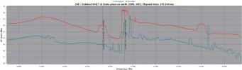

Hi again Huevos ..
Probably my last post for tonight ..
Need to get a bath and early-ish to bed..
Hospital appts tomorrow ..grueling day for me ..whilst they run their many tests on me and my MS..
hope these scans give some idea..
Taken on the 1.25 Gibby at 21:30
rgds
VS
So your signal are nowhere near what the German boys are posting. Anyone in Germany post a scan of 12460H at this time? Been watching this transponder for the last hour and signal strength hasn't changed so would be an ideal time to compare readings.

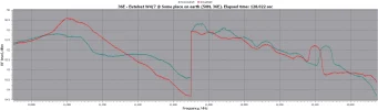

i got it 12460h 40%
and 12401v both signal low nowit
good position testing gsat 10 c band and ku band
near the home
Indeed not Huevos ..but this _may_ be down to the troublesome tree ..as I am very close to the point of obscurity...
Also possible that the arc isn't yet perfect on the H180 tracking.
Tomorrow I'll release the ties on the TD110 & TD88 ...which have a clearer perspective.
Both have been tied down today ...because of the extreme gusts of wind this morning.
rgds
VS

this morning two transponder tested 12401v and 12460h it weak signal need 3 meter dish to get it over mideast

for now saw signal low band 11538v and11623h
11680h band of eurobird

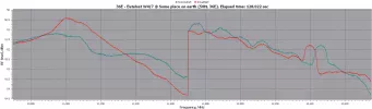

miha20
Nov 1, 2011
85
94
Kiev, Ukraine
This is what I see @17-56 CET in Kiev
2,379
3,376
That 12.188H one is strange. Seems to be a wider carrier than the others, but also much weaker, I cannot get a constellation from it. It's no Turksat overspill.
Confirm 12188H comes from Astra 2F direction. The bump here is also about 2.5 dB above noise.
