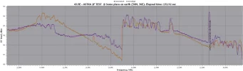

11345h very low now
but have havey rain now
i cant good signal

I presume all those other carriers are the dishes side-lobes picking up from 42E or 45E?

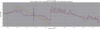

12460H back strong signal now
it pe beam

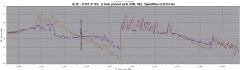

after stop rain signal litel better 11340h
