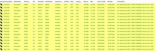

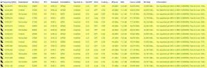

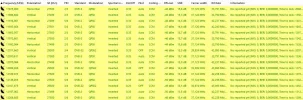

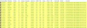

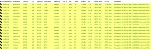

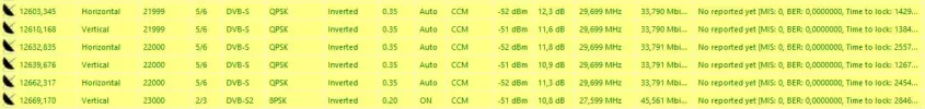

John, your results don't correspond with mine at all. Famaval 1.8m. BBC2 England, 11.7dB. C5 11.4dB.
Morning,
Well, arrived back last night at 21.30hrs and got the same results on the Marrafa and Famaval but this morning with the Famaval things are 'better' as a 7.00hrs scan:-
28.2ºE  18-06-2015 c  07.00hrs.JPG 28.2ºE  18-06-2015 d  07.00hrs.JPG 28.2ºE  18-06-2015 e  07.00hrs.JPG 28.2ºE  18-06-2015 f  07.00hrs.JPG
So H and Brian.....having used the Famaval with the TBS5925 card and the Marrafa with the onboard Samsung 48'' LED tuner.... both showing as posted yesterday and this morning scanned with the Famaval and TBS5925 as above.....¿¿¿???
Would say that initially yesterday having used two seperate scan mechanisms that the results were correct and certainly this morning 10993 H and 11023H the dB is lower .......whatever....pleased that you both retained the frequencies and helped me take a look this morning.
¿Is there much change for yourselves dB wise this morning?
C5 is up to 12dB now. Is this really a different satellite? Or was it just doing some station keeping maneuver that caused us to see a signal change. Once I've got 24 hours data I'll be able to compare. If I had to guess I'd say all these transponders are on the same satellite as 24 hours ago.
