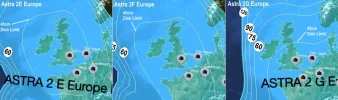

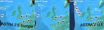

I posted this on another forum but I thought I'd add it here too. It shows the differences in Astra 2G's Europe footprint over the UK compared to 2E and 2F.
The images are taken off SES's official iPad app and suggest 2G Europe beam won't be good news for Scotland or Ireland in its current form. As a result I don't think it'll be used much, if at all, at 28E for TV.

12,277
12,350
That information conflicts with this http://www.ses.com/fleet-coverage,
Below the 4 beams from Astra 2G.
I think the 1st 2 images in tim0_w2's link are correct for the UK spot beam but the third image for 2G is for the European beam not the UK spot beam.

I'm just comparing the European beams from each of the new generation satellites. The published UK beams from all three are virtually the same.

Hi timo......would you possibly have the complete images that show the total footprint coverages as opposed to just the U.K. view.
Thanks for that. :)
Here they are. For 2E and 2F a large part of the Europe footprint is over the Atlantic. For 2G it is more focused on central Europe, at the expense of northern UK.
Superb.....thank you.
