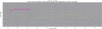

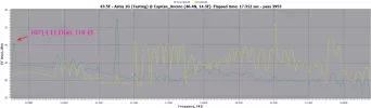

Now a strong carrier on 10832 H, and a wideband peak around 10714 H.
I've been seeing a slight peak on 10832 H already for several days during the travel to 43.5°E !
Probably an "open" transponder without uplink.

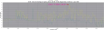

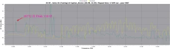

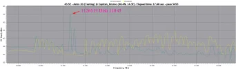

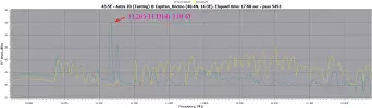

12033 H
ps_It looks like they are doing tests on another satellite at the same time,because right now it's not a signal on this carrier!?
12,278
12,354
Perhaps,because after scanning the signal disappeared.Around this time started a new transponder at 12655 V, which is on Astra 1F,but also this transponder left.So far this transponder doesn't really exist.There are tests on Astra 1F?

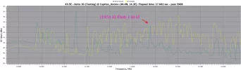

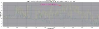

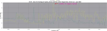

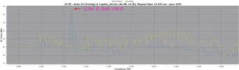

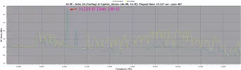

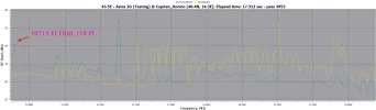

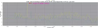

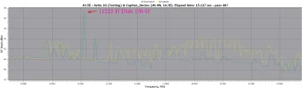

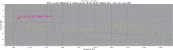

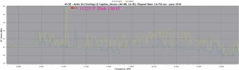

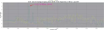

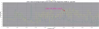

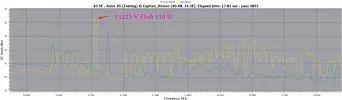

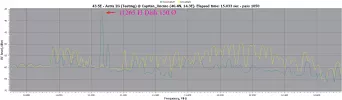

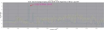

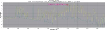

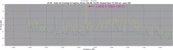

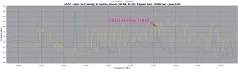

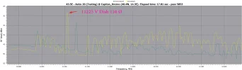

Test signals observed up to now, with dish 110cm
474
1,846

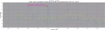

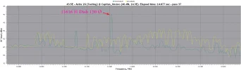

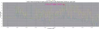

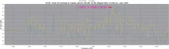

...and dish 150cm
2,394
3,414
11225 H/V and 11265 H tell me a lot! Tries to mimic the current 28A transponders (72 MHz split in two).
A scheme to fit 72 transponders (excluding the 10 * 36 MHz Africa transponders) could be:
10.7...11.2: 32 * 26 MHz
11.2...11.29: 4 * 36 MHz
11.45...11.7: 12 * 33 MHz
11.7...12.19: 24 * 33 MHz
Only trouble are 11616 H and 11692 V, especially 11692 V can't be center frequency.

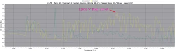

Testing began today with 11265 V

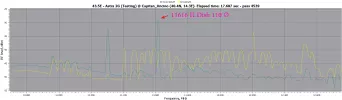

11614 H
