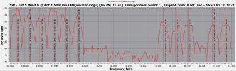

what does it do with DVB multistreams such as those on 5.0W.
IThe TBS 6522 doesn't lock on this example multistream TP for me. Fine on a regular transponder with an equivalent signal strength.

2,180
3,159
@Llew, I will check the 6522 cards on the MIS at 5.0W, but until then, I will say that the last time I checked it at this position, the card worked fine with Crazyscan, and I could use it for Italian and French TV programs.
