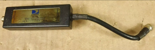

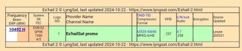

Works here directly with Revez HDS610 + IBU. It's possible to receive with normal LNB if receiver can tune 10492, but unfortunately most have software limitation at least.Someone already lock this channel ?
I suppose that a Bullseye lnb is compulsory

There are also specific LNB's for sale with a LOF of 9 GHz which converts 10.0-10.7 GHz to 1000-1700 MHz.
You just use the Bullseye LNB without a convertor?Just try it with Bullseye lnb but still doesn't have these frequencies.
