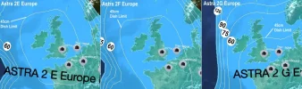

The European beam on Astra 2G below covers Southern Finland better than 2E & 2F European beams so they may use this for Sky subscribers?
If they use it for Sky then people in Scotland and Ireland will need to keep their Zone 2 dishes.astra2efg-europe-in-uk.jpg
