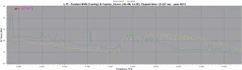

467
1,811
Appeared two signals at 1,7°E, 3740 L and 10736 H... confirmed?
