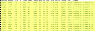

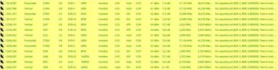

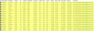

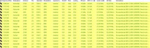

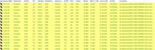

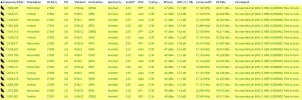

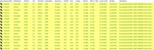

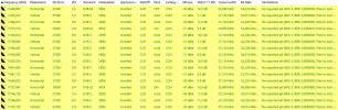

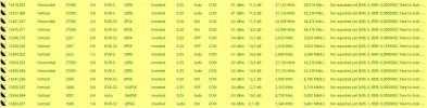

Scan with the 1.2m only..........apologies, will sort out the different sats later, I hope:-

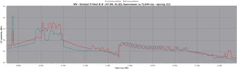

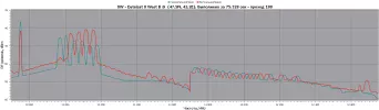

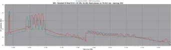

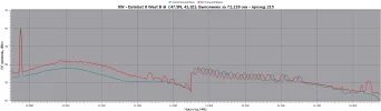

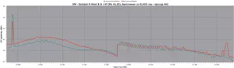

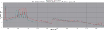

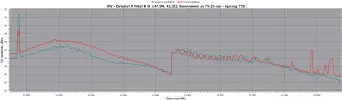

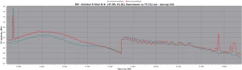

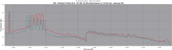

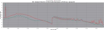

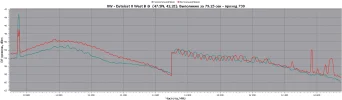

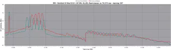

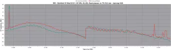

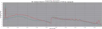

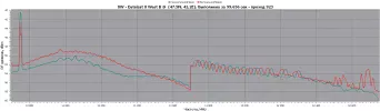

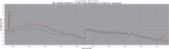

Transponders switching pictures from my location.
The spectrum below 11700 MHz from 7-8°W is almost clear for me now. But I have increased signals in subband 12500-12750 MHz.
