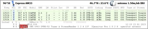

96.5 E@ Express 103
There will be extreme reception enthusiasts on this forum, now that there are many members from several reception areas. Perhaps one of them could receive Express-103 at 96.5E. I would ask the one who arrives with the antenna at this position to try to lock the upper band frequencies.
If interested in an update on the transponders from this satellite, I post what I found at 96.5E.
Thanks :)
12509 V,2859,4/5,32APSK-unlock,
12514 V,6294,4/5,32APSK-unlock,
12521 V,2600,4/5,32APSK-unlock,
12523 V,867,4/5,32APSK-unlock.
ps_Too bad @RimaNTSS's antenna doesn't "travel" in orbit. It would have been a good opportunity to check these frequencies,especially since it is placed in a favorable area for far eastern satellites :)

I revisited 96.5E. Nothing special but the same questions that were not answered, i.e., who can confirm the existence of muxes in the upper band?
The signal is relatively weak, so only with IQmonitor, was I able to capture and lock these muxes.
I would say that reaching an extreme of the arc is in itself a (mechanical) performance and not the reception as such since there are very few users who report such ...extreme reception (@moonbase, perhaps this should be included in your list of extreme receptions(?:)).
@dreamsat, if you have reached 96.5E, please check the upper band where some transponders you see on my spectrum are, probably Data.

Thanks for trying,@moonbase, and I really wish you could catch Express-103 as well, but I'd rather keep dying to be sure if these muxes in the upper band are really at this position or 97.3/97.9E.
At such a low elevation, it is tough to identify the position with a small antenna.
Fingers crossed that you make it. :Y

96.5 E@ Express 103
Thanks :)
Τhese frequencies comes from SES-8 / SES-12 @ 95°E
