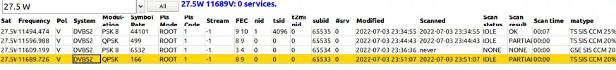

The lowest symbol rate locked (Partial) so far with neumoDVB for the 6903x card is 256 Ks/s at 10.0E! This in itself is a performance that I didn't think possible with this card.
Here recently with 6903x with Deeptho's application I managed to reach another threshold, which I didn't even dream what it is capable of, namely, locking symbol rate of 167 Ks/s on 11689 V,167.8/9 at 27. 5W. What's interesting in this case is that the signal from this satellite has no coverage at all in my area, even more so since Intel 901 began operating at this position. And even if I had the strongest signal, I didn't expect neumoDVB to be able to do that.Probably if the signal was stronger and more stable I would get more.
Also on this satellite we have the radio package at 11596 V,500,8/9. This one I have locked more easily.
I don't know if it's possible, but the next step Deeptho has to do is to get the Scan Result not with "Partial,but OK when we lock the low symbol rate. That is to say we can use the stream (media) of the transponder with low symbol rate.
By the way,a last try with 6903x to lock 185 Ks on 11697 V at 30.0W is promising. It's the first time I see the signal on the quality bar at 11697 V, without any additional information.
I should also add that the tests on these low symbol rate transponders I did with a dro(IBU) lnb. In this scorching heat, a PLL lnb would hopefully give a more conclusive result.
Attempt at locking the Mars radios unsuccessful with the 6903X. In particular, I tried 11689V as you were successful, but it doesn't lock.
A PLL LNB might be better, but it would mean replacing it on the dish, which is out of the question at present.
I don't even see 11596V :confused
I will check my LNB (Inverto KA/KU) for accuracy on my Promax Ranger to try to find its true oscillator frequency, then apply any changes to the tuned Mars frequencies.

I confess that I am glad I am not alone in these tests. The more testers, the better the results.
I can't figure out why you can't lock 11689 V at 27.5W? Theoretically, you're more likely to get it because you're in the spot, so the signal is stronger.
I don't know if you've ever tried to catch this transponder with Crazyscan, under Windows, with the 6903 cards. You have a better chance of success than now, the first time on Linux.
On this Intel 901 there are some low symbol rate transponders besides 11689 V, namely :11591 V,250,8/9,11685 V,166,8/9,etc(see FS).
These low symbol rates, and others, are a double challenge, one for Deeptho to find a solution to lock them under Linux which is not possible on Windows, and on the other hand, for us, enthusiasts to be able to receive them!
I have installed the formidable neumoDVB for this reason. I am trying to test these DVB cards with Deeptho's application to know if some of the limits observed on Windows are of the cards or of the application?
I have to admit it's a strange claim, and probably unrealistic.
Regards :)
I get the occasional IQ QPSK showing for 11689V in Windows with my 6983 card, but no lock.
I think I have less patience or your 'golden touch' with these TPs. I'll come back to them in due course, just need a break from these in particular :-ohmy

Maybe we should organise a contest "how low can you go?". Here is a result with tbs 6909X:
27.5W 11690.178V 167 kS/s DVBS2 - QPSK. This mux locks reliably. I guess one factor is the DVBS2 nature
and another that it is well separated from all other muxes.
There is DVB data on this mux, but no PAT, SDT nor nit. Below you can see that this contains a
number of audio streams. One of the streams has silence, the other one has an Irish radio station: "Irish classic hits"
The way to listen to them is a bit involved, as neumodVB does not detect valid SI tables (there are none).
1. start neumodvb and make it lock
2. run dvbsnoop -adapter 2 -s ts -tsraw -b > /tmp/stream.ts
3. run mpv --aid=2 /tmp/stream.ts
Obviously, adapter number has to be changed to whatever is appropriate.
=============================================================================== | TRANSPORT STREAM ANALYSIS REPORT | |=============================================================================| | Transport Stream Id: ............. Unknown | Services: .............. 0 | | Bytes: ........................... 938,496 | PID's: Total: .......... 3 | | TS packets: ........................ 4,992 | Clear: .......... 3 | | With invalid sync: .................. 0 | Scrambled: ...... 0 | | With transport error: ............... 0 | With PCR's: ..... 2 | | Suspect and ignored: ................ 0 | Unreferenced: ... 2 | |-----------------------------------------------------------------------------| | Transport stream bitrate, based on ....... 188 bytes/pkt 204 bytes/pkt | | User-specified: ................................... None None | | Estimated based on PCR's: .................. 287,399 b/s 311,858 b/s | | Selected reference bitrate: ................ 287,399 b/s 311,858 b/s | |-----------------------------------------------------------------------------| | Broadcast time: ................................... 26 sec (0 min 26 sec) | |-----------------------------------------------------------------------------| | Srv Id Service Name Access Bitrate | | | | Note 1: C=Clear, S=Scrambled | | Note 2: Unless specified otherwise, bitrates are based on 188 bytes/pkt | =============================================================================== =============================================================================== | SERVICES ANALYSIS REPORT | |=============================================================================| | Global PID's | | TS packets: 92, PID's: 1 (clear: 1, scrambled: 0) | |-----------------------------------------------------------------------------| | PID Usage Access Bitrate | | Total Global PID's ................................. C 5,297 b/s | | Subt. Global PSI/SI PID's (0x00-0x1F) .............. C 0 b/s | | 0x1FFF Stuffing ..................................... C 5,297 b/s | |=============================================================================| | Unreferenced PID's | | TS packets: 4,900, PID's: 2 (clear: 2, scrambled: 0) | |-----------------------------------------------------------------------------| | PID Usage Access Bitrate | | Total Unreferenced PID's ........................... C 282,102 b/s | | 0x00C9 Unreferenced ................................. C 141,109 b/s | | 0x012D Unreferenced ................................. C 140,993 b/s | =============================================================================== ============================================================================== | PIDS ANALYSIS REPORT | |=============================================================================| | PID: 0x00C9 (201) Unreferenced | | PES stream id: 0xC0 (Audio 0) | |-----------------------------------------------------------------------------| | Unreferenced PID Transport: Discontinuities: | | Bitrate: ... 141,109 b/s Packets: ......... 2,451 Expected: ......... 0 | | Access: .......... Clear Adapt.F.: ........ 1,320 Unexpect: ......... 0 | | Duplicated: .......... 0 Sections: | | PCR: ............. 1,225 Unit start: ..... 204 | | TSrate: .... 287,399 b/s | |=============================================================================| | PID: 0x012D (301) Unreferenced | | PES stream id: 0xC0 (Audio 0) | |-----------------------------------------------------------------------------| | Unreferenced PID Transport: Discontinuities: | | Bitrate: ... 140,993 b/s Packets: ......... 2,449 Expected: ......... 0 | | Access: .......... Clear Adapt.F.: ........ 1,224 Unexpect: ......... 0 | | Duplicated: .......... 0 Sections: | | PCR: ............. 1,224 Unit start: ..... 204 | | TSrate: .... 287,399 b/s | |=============================================================================| | PID: 0x1FFF (8191) Stuffing | |-----------------------------------------------------------------------------| | Global PID Transport: Discontinuities: | | Bitrate: ..... 5,297 b/s Packets: ............ 92 Expected: ......... 0 | | Access: .......... Clear Adapt.F.: ............ 0 Unexpect: ......... 0 | | Duplicated: .......... 0 Sections: | | PCR: ................. 0 Unit start: ....... 0 | =============================================================================== =============================================================================== | TABLES & SECTIONS ANALYSIS REPORT | ===============================================================================
And here is another mux nearby. It does not lock and neumoDVB does not report frequency and symbol rate, even though it probably could in
this case because the timing loop has locked: 11671.708V. Of course it may just be that there is no dvb stream on this mux.
It is clearly QPSK, but not sure if it is DVBS-1 or DVBS-2
