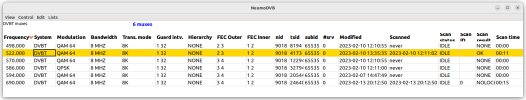

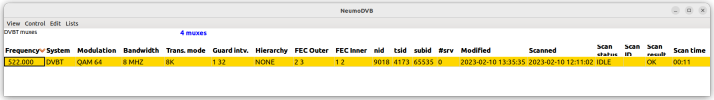

DVB-T mux deletion working fine, keeping the OK mux. I removed my DVB-T services too, so they are automatically taken out of the Channel list (were numbered "1", leaving Enex Path 1 16E as last listed channel.

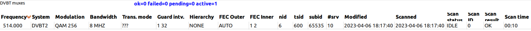

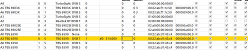

With today's update (#de61b60 ), I managed to scan all the cable muxes, but before that, I deleted all of them and, simultaneously, the Services. So it worked. Thanks, @deeptho :Y
For the terrestrial reception configuration, I admit I was annoyed, and it took me a long time to find the solution to lock the signal and scan the terrestrial services for the 6590 C/T card. Compared to my first experience with terrestrial reception with neumoDVB, last August, with this version, I had to choose 1 for priority, for the card and the standard (terrestrial) to work and show my subscription.
I don't remember than having to give priority 1 to the adapter for terrestrial.
