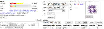

Back to 26.0E with a neumoDVB version 1.2 test after switching to the lnb setting before the dvb cards (v.1.1). I tried scanning Amateur Radio on 10491 H,1500,4/5 at 26.0E with the lnb set to 10.5 GHz, as the documentation states. This lnb setting does not work on muxes between 10490-10499 H. The only way to lock these muxes is with lnb 9.75 GHz at LOF Low, setting the scan limits between 10470-11200 H or narrowing the search band even more.
My first test was with the 5927 tuner, also recommended for these low sub-band muxes. I also had no problems locking Mux with a symbol rate of 333.
I also tested the 6983 card with the same lnb configuration for Amateur Radio reception. This time I also had no problems locking some frequencies.
With the 6903x card, I managed to do a normal scan of these muxes, getting a normal spectrum.
The problem was only when I scanned it manually, it gave me a parameter error, i.e., instead of the 10491 H frequency, it scanned 12040 H, although the other 10490 H parameters were preserved (sr & FEC).
I would like to know if another valid setting exists for the lnb so that I can scan and lock these Amateur Radio muxes.
Or even better, how is it correct to set LOF Low, freq min, freq max, etc.?
"Setting the LNB to 10.5Gz" is not mentioned in the documentation, which mentions setting freq_min to that value.
That will only work if the card supports it. 6903x does not.
The LOF value should be set to the correct one for the LNB, which is indeed probably 9.75GHz if it is a Universal LNB.
The value -1 is also fine. It then picks that default.
So in summary: all of this works correctly for you (except for the impossible parts)
Difficult to comment without any further information.
Well, it is exactly as the documentation states, with possibly one exception: the lowest and highest frequency that can
be tuned to are not only determined by the lnb but also by the card. So not all values will work. The only limit that is internally
checked is the one for the card. The other limits (for the lnb) you have to set yourself. The LOF value needs to be the correct one
as written on the LNB.
If IF-LOF=BB (10492-10500=-8) or LOF-IF=BB (10500-10492=8) is used, then for both cases the resulting BB is nonsense. 10.5GHz will be the beginning of the range rather than the LOF.
LOF can be easily verified in L-band IF-BB=LOF (10492-742=9750)

The card processes frequencies approximately in the range of 0.3 to 2.5 GHz (officially 0.95-2.150 GHz), so it does not matter at all what the LOF of the LNB is as long as the output frequency from the LNB is in this range. The LOF value is important for displaying the "imaginary (broadcast)" frequency in the program.
It does matter that the correct information is given to neumodvb. It also matters if the LNB can actually output the lowest frequency
told to neumoDVB. There are physical limits
Yes, that is the correct LOF. That is what I wrote...
