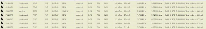

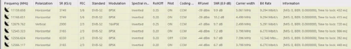

Been spending a while finalising the two Ravens, I have got them as good as they'll be and have some interesting results between the RX Feed Arms model and the TX/RX heavy duty arms:
Scan of 16e on both 2 minutes apart, currently raining but OK for a comparison, showing about a 1-1.5db difference towards the TX/RX arms. Some freq comparisons are a bit higher than others which makes me wonder if I need to tweak the LNB skew a bit on one of them.
127263
127264
36,082
8,758
The arms themselves 'shouldn't' make a difference of course, but unless you have LNBs with identical characteristics and there are no differences in the reception a couple of metres apart, you might be looking at subtle reflector imperfections, though again there shouldn't be. Try running a metal detector across the whole surface to verify the mesh runs right to the edges.
Even assemblers at the factory can have a bad day.
