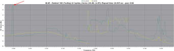

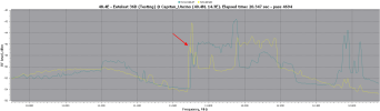

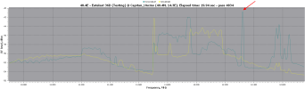

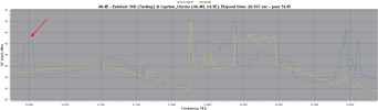

This afternoon, carrier testing began...
Around frequency 10790 H
Full
Around frequency 11680 V
Around frequency 12320 H
Back on frequency 10790 H
Full
The telemetry frequencies have been switched to linear polarity (11701.80 V and 11704.00 H). Previously in LEOP phase, they used the frequencies 11701.80 and 12501.00 in circular polarity.

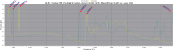

They have been testing on six frequencies since last night... 10739 V, 10784 H, 10867 V, 11609 H, 11692 V and 12742 H. The signals are not always active and change emission power very frequently.
