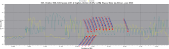

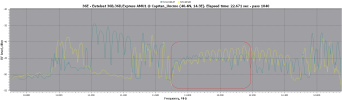

The transponders of the Sub-Sahara Africa beam have migrated to 36D: EA1,EA2,EA3,EA4,EA5,EA6,EA7,EA8,EA10,EA12,EA14,EA16,EA18 and EA28.
While the transponders EA9,EA11,EA13,EA15,EA17 and EA19, which on lyngsat and flysat were reported on 36B, but were actually on the Express AMU1... were not affected by migration.
Before
After
