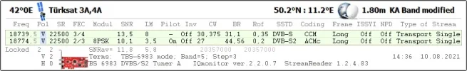

with a 1.80 m Channel Master I receive today
only two frequencies (stronger in V than in H)
Stephan94,
You may need a piece of PTFE down the mouth of the LNB at 45 degrees to the probes to create circular polarisation. That should improve reception.
