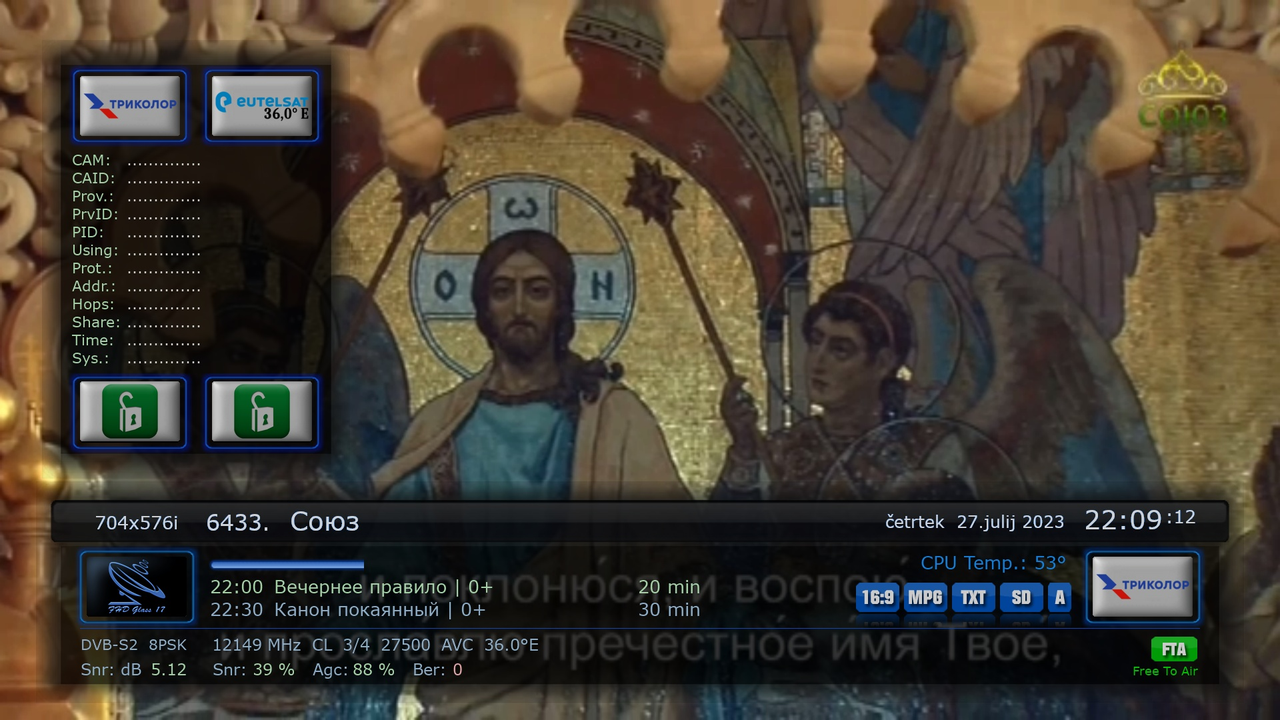

Recently the modulation of the Tricolor package has been changed from 8PSK to QPSK-S2, consequently gain needed for lock split almost in half.
Despite linear feedhorn/LNB I still get enough to lock this single frequency (12.149 LH).
