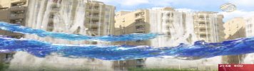

12655 H is active with a UHD promo, SR is 2475 FEC 2/3. Legend Alforat HD2 Neither the Octagon nor the GTMedia Combo are clearing the video, but the latter is having a good go.20230206_120459[1].jpg
36,050
8,741
Odd. the 8008 believes it is on a slightly different frequency and in SD.

UHD with a SR of 2475 / FEC of 2/3? Goodluck with that
