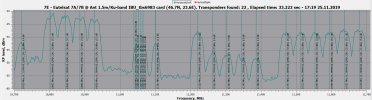

I am just now finding out that in England, the reception of this beam was/is a big problem. But I must say that since I received Eutelsat 7B from the beginning, the signal on 10720 H has always been weak. Only in the morning, in good weather conditions, it increases by 2 or 3 dB.
It is true that, although my area is out of the spot, I am still closer to the beam. That helps me to catch it though
And I wonder why, knowing there is a problem with the signal reception in your area, you only ask the question now. Or were there times when the European B beam could catch it?
Here's what signal I had on this spot in 2019 at 10720 H and between 11200-11400 H, about the same signal level as today.

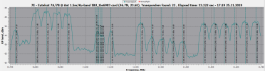

Scan 23.00hrs seems to show a stable recption of the 'European B Beam' known transponders (as, Flysat) highlighted in yellow......... Alicante 1.2m............
