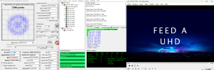

10991 V,22856,25/36,(S2x)/16APSK,0.05,HEVC 4.2.2.-UHD feed(still FTA)7.0E_
2,180
3,148
At the moment, this feed UHD-10991 V-is still FTA.
CPU is almost at 100%

10991 V,22856,25/36,(S2x)/16APSK,0.05,HEVC 4.2.2.-FTA

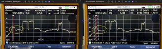

For us in the UK there is a little trick to help to get lock with this particular low level frequency, which also suffers from lock loss from the very strong signal on 10.722 Ver as well, and that is our old friend Skew.
In the two side by side analyser grabs, by moving the lnb Skew just one or so degrees lowers the strong problem Ver signal cross pol problem in the lnb sufficiently to let the wanted Hor sig to get through.
On my lashed up experimental lnb changer on my 2.2m PF and from my stash of bits and bobs iv'e lashed up a servo motor to give me motorised Skew and this is working out very well for use on the 2.2m PF.
A few lash up pics.....
Eutelsat 7B @ 7.o°E.JPG7East Europe B beam. Skew used..png7° East - 10.721H Europe B beam - - With and Without Skew applied..jpg2.2mtr Ku Skew prototype.JPG

Yep agreed CJ and the more you come up country in the UK from the South into the Midlands where i am the signal gets very thin , the further North you go it's even worse.
View attachment 157692View attachment 157693View attachment 157694View attachment 157695
I should perhaps point out also that Ku use on my 2.2mtr install is for weak DX signal spotting and not for looking at strong broadcast signals on Co Channel Hor / Ver positions as that would just be asking for trouble - i would normally nudge the dish slightly off beam in this case OR use my 1.2m Ku band CM install.
For those trying to get this beam, remember that many Eutelsat craft have a skew +3.535 deg relative to most others. Hence, if you set your skew on Astra, for example, you're unlikely to get 10720H on 7E.
The attached list is a few years old but still valid (Calculation of Azimuth, Elevation and Polarization for non-horizontal aligned Antennas Algorithm Description Technical Document TD-1205-a Version 3.0 11.02.2019). If anyone knows of a later version, it would be very useful.
