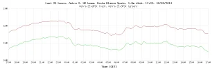

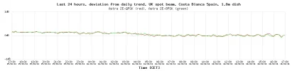

Huevos has been plotting signal strength for some time now and it does look like there has been an increase in signal strength since 11 Feb. Please see attached charts.
The second chart shows the 2E SNR reference to C4 HD on 2F. This shows 2E has increase by about 1 dB reference to 2F since 11 Feb. Using a reference reading takes out climate effects as both 2E and 2F should be effected about the same.
I would say as 2E is new the increase is probable due to SES adjusting the direction of the satellite beam to get optimum coverage over the UK and we are seeing the effect of this adjustment.
I realigned the dish at 2014-02-11 17:15. Picked up quite a bit of signal on 2E for no loss on 2F. This allows for the slightly easterly positioning of 2E. But this is nothing to do with the power level coming down from the satellite. 10847V has always worked 24/7 for me on a 1.1m dish. And if you compare the last 24 hours against the daily trend since the satellite was switched on you get a dead flat 0dB line, so absolutely no change.
And here are today's levels used for that comparison.
And here is a screengrab of BBC1 HD using a 1.1m dish at the lowest signal point of the day according to the above graph.
Hi Huevos, I am not arguing your observations but just adding a little bit to the equation.
I have not realigned my dish and or LNB since before start of 2E, I had my dish adjusted for maximum performance with 2F, it is a 1.2 Tecatel offset, I spent the best part of an hour with a Prolink 4C+ so I am sure that at the time was perfect, last time I did readjusted was a few weeks before 2E.
When 2E was launched and BBCH HD was moved I lost BBC HD from around 2:00 to 7:30 and from around 17:10 to 18:00, a few days ago I saw that I had a power increase of around 1.5db being shown on my DM800S meter and as a result I had BBC HD 24x7, so my quick assessment was that there had to be a power increase or satellite attitude realignment, but your observations may indicate otherwise.
I am reluctant to believe that the wind had realigned my dish ^_^ but I am going to realign the dish to 2E to see if there is further gain.

Salva, all my records are from a 1.8m dish. That is the dish that was realigned. I realigned that dish after seeing 2E was not at 28.2E, but 28.35.
The 1.1m dish is connected to the first tuner on my Vu+ Ultimo because that is the preferred tuner on that receiver and that is the receiver that is used for daily family viewing so would give me early warning of any potential problems. Dish is a Famaval LH110, so nothing special.
The satellite has only been on for 10 days so far. To make a useful graph with one pull every 24 hours you'd need about 150 days data. All my daily graphs do one pull every 10 minutes so output is 144 increments. But if you go through current data (allowing for the realignment on the 11/2) each day is within a couple of tenths of a dB of the first day's records (sometimes lower, sometime higher).
