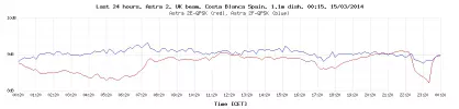

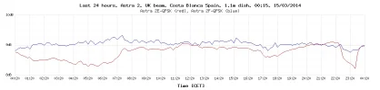

I could still do with some help understanding why 2F drops much more than 2E. I understand more txp´s means more power from batteries, but that alone cannot explain the big variation in sig strength, and also timing of drop off. Does the altitude and exact geo position also have an effect, ie higher satellite is in shadow for shorter time, and one being at 28.2 and the other at 28.35?
They're all at the same altitude, otherwise they wouldn't be "stationary". And the 0.15º just means 2E goes in and out of the shadow 36 seconds earlier.
Here's what it looked like for me today on the 1.1m. No pixelization.

Archive4
Huevos, if you have the time, could you do a graph against 2e sd and hd over 24H so we can see the difference

Don't know if of any relevance or interest, no change here on 10818, same strength and behavior as 10773, 10788, 10832, 10891.
Just how low did the blue bar go!
Not quite as simple as that. The blue line is the average of the 3 8PSK transponders on 2E. That down-spike is one transponder (10862) going offline.The other two continued without problems.
The problem is if a transponder goes offline it shows as an 8dB drop when in reality it might only be a 1dB loss. Best thing is put this measuring back on the bigger dish.
