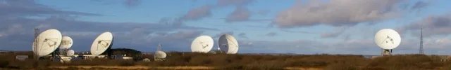

Pehaps this is what you need, Goonhilly 6, 32m ku and c band, now I believe has been upgraded to include X and Ka band, should be ok for community installation! ( I worked there for a while, a few years ago)
Uhm - that's a nice dish. I bet it gets EVERY satellite visible in the UK.... Can I have one in my back yard?
Archive4
Depends on your bank balance!
And according to Huevos, local planning rules!

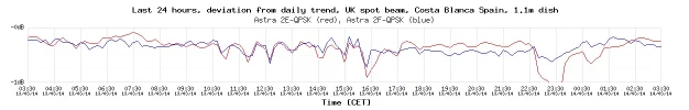

Has anyone else noticed a significant drop in signal strenghth today - both 2E and s2F beams? Atmospheric conditions I guess but the weather hasn't changed much over the past few days.
Yes. It's down about 0.5dB compared to normal. But there has been heavy cloud and some rain today.
Archive4
Huevos, have you formulated any theory as to why 2e drops much more than 2f between 22:30 and 23:30, when on batteries? Is it possible they have a different battery type, not able to sustain the same power output, or is it anything to do with altitude, or exact geo location?
No idea! Has 2E got more active transponders?
Archive4
At a quick count, according to flysat, only four or five more, can it make that much difference?
Ok before you reply , roughly 20% more power required, but don´they build that into the equation before they put the bird up there?
