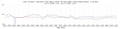

Is 2F weaker than usual too (i.e. is this environmental factors)? I haven't noticed any 2E picture breakup, but we've had clear skies most days.
Both are weaker. Here's a graph of the last 24 hours compared to the last week in February.
Just one. 11053. Probably just the receiver not locking quick enough.
