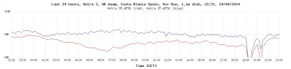

Just had a major drop in signal in my area at 21:05 approx, had reception problems on a few ch´s, esp ITV on 10891, back now but weaker than normal. We do have low clouds and light riain, but this is the first time I have noticed this since 2E went on line. (Had to happen when SWMBO was watching Emmerdale!)
No, this is signal lower under clear skies. Did have a bit of rain earlier though (around 8pm) and lost every transponder on the 1.1m dish.
