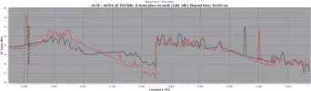

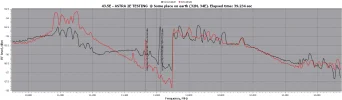

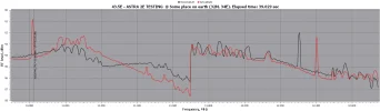

Hello,
That's how it looks from Kiev
4 freqs with changing power, maybe they are also in different beams
