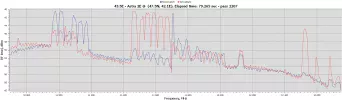

It seems from reports that currently only Band D has been tested on UK beam
6,623
3,831
12403v 4db

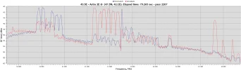

I receive quite strong carrier on 12400V right now

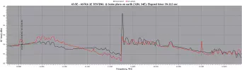

12304 H active now, also 12402 V

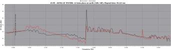

Yes,12400 V-6.1 dB.

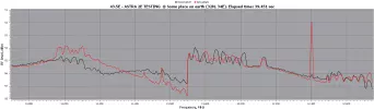

Strong peak on 11709H right now
